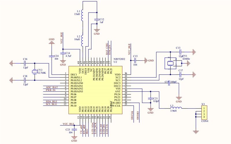

i have used a example of ble_app_template in ble_peripheral of SDK15.0,when code run in ble_advertising_start,return errcode 8.
i have checked low speed Crystals,it's ok。 i don not no what's happen .please give some advice,thank you.
If you check the ble_advertising_start() description in ble_advertising.h you will find that error core 8 equal NRF_ERROR_INVALID_STATE. This happens when you call ble_advertising_start() before the library initialized using ble_advertising_init().
my PCB info:4 layer board(TOP layer 、 singal1 layer、singal2 layer、bottom layer),PCB thickness is 1.6,Copper thick is 0.5 OZ,
It seems normal. Please try stepping into the code and find where exactly it throw error code 8 and why.
i have tried this methods.
if Step through the code ,when run to switch (p_advertising->adv_mode_current),it will run long time ,then get the error code , when Breaking point after the switch struct,it will run to p_advertising->evt_handler(p_advertising->adv_evt),then get error.

I don't really get it. Which function returned error 8 ? Could you please take a screenshot where you find error 8 ?
Note that to debug with softdevice you would need to change the optimization level to 0 and you may not be able to step in the code but would need to use logging or breakpoints instead.
