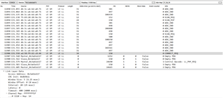

    Now I am trying to setup sniffer to capture packets bewteen D2 & D3. This is what I am doing:
    • Configured following versions of s/w: nrf_sniffer_for_bluetooth_le_3.0.0_129d2b3, Wireshark 3.2.1 as per nRF_Sniffer_UG_v2.2.pdf
    • I can see nRF Sniffer for Bluetooth LE COM29 in interfaces and select it to start capture
    • Select device D3 in list of devices (WLSab6da871, MAC db:3c:ab:6d:a8:71)
    • Start connection bewteen D3 & D2
    • I see connection request on D3 but then capture stops and no data between D2 & D3 is captured. Sniffer automatically starts capturing some other devices
    Is there any other constraint for sniffer to work? Since D3 & D2 uses coded PHY to communicate, can sniffer capture coded PHY packets?
    thanks
    Ankur
  • I suggest you use Rev 3.1 of the sniffer: Revision history.
    That sniffer trace looks alright. A CONNECT_REQ, followed by empty PDUs (to maintain the connection), and a LL_PHY_REQ.
    Can you share the rest of the sniffer trace?
