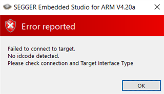

When I try to connect my device with Segger Embedded Studio. It gives me an error.
"No idcode detected".

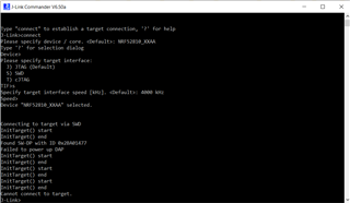

Also, I tried to connect it with JLink Commander v6.50
In that, I am getting an error like
Connecting to target via SWD
InitTarget() start
InitTarget() end
Found SW-DP with ID 0x2BA01477
Failed to power up DAP
InitTarget() start
InitTarget() end
InitTarget() start
InitTarget() end
InitTarget() start
InitTarget() end
Cannot connect to target.
