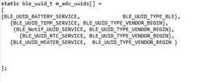

when I kept on trying to advertise multiple services.In one way I was able do it.i.e I simply added services to m_adv_uuids and set appropriate value for NRF_SDH_BLE_VS_UUID_COUNT
and changed ram start location and ram maximum size.I found that five services that I have added in globally declared array i.e m_adv_uuid are able to advertise and scan on nRF Connect for mobile.

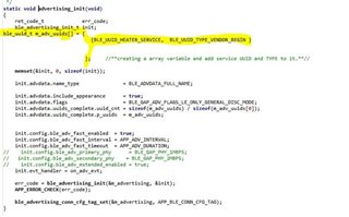

Then when I was rechecking the code I found that there is also locally declared m_adv_uuid with one service in it.I just commented it out and then tested again application then I was stuck with an error12.Again if I remove comment and check its working status then again it is able to advertise all the services which were declared globally.The below are the code snippets.
This is the globally declared array.
In below image If I remove highlighted statement it is displaying error12.If I run by including that statement then I am able to advertise all declared services.
Can you please let me know if the approach that I have implemented is correct or not?In this way I am able to make services available at a time to the user.But unable to understand what that locally declared variable is doing internally.

    You may know that when you don't use AE , the advertising packet size is limited to 31 bytes for advertising packet and 31 bytes for scan response packet.
    Each 128 bit UUID is 16 bytes. How can you fit them into advertising packet ? There are many overhead needed as well.

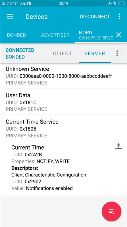

  • There is no connection between the advertising data and the actual attribute table (available in connection). The advertising data can have one or some of the services that available in the attribute table but it's not obligatory. If you have an issue with iOS you need to describe it, I don't see that in your question.

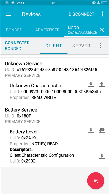

    Please pay attention on the UUID declaration you have. From the screenshot I saw, they look very strange. Please write down here the UUID list of your service and characteristic, would it match with what you see on Android ?
    Which app did you use on iOS to test it ?
    Please post the code where you declare your service and characteristic.
  • Which app did you use on iOS to test it ?
    nRF Connect.
    The UUID present in array is
    #define BLE_UUID_TEMPSERV_BASE_UUID {0x86,0x42,0x0e,0x57,0xce,0xfd,0xb3,0x96,0x47,0x4f,0x11,0x8c,0x00,0x00,0x95,0x82}
    UUID generated is
    8295923d-8c11-4f47-96b3-fdce570e4286

    Thanks for the UUID but you mentioned you have 6 services how do you define them, which UUID they have? in the screenshot you provided I don't see the UUID 8295923d-8c11-4f47-96b3-fdce570e4286 being used.
