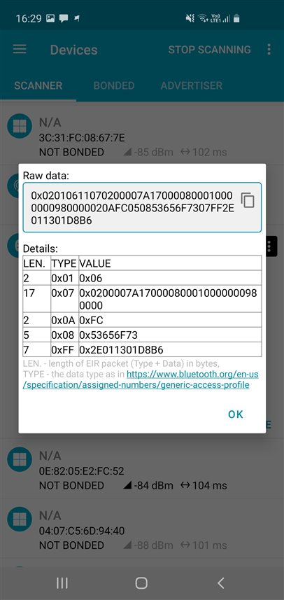

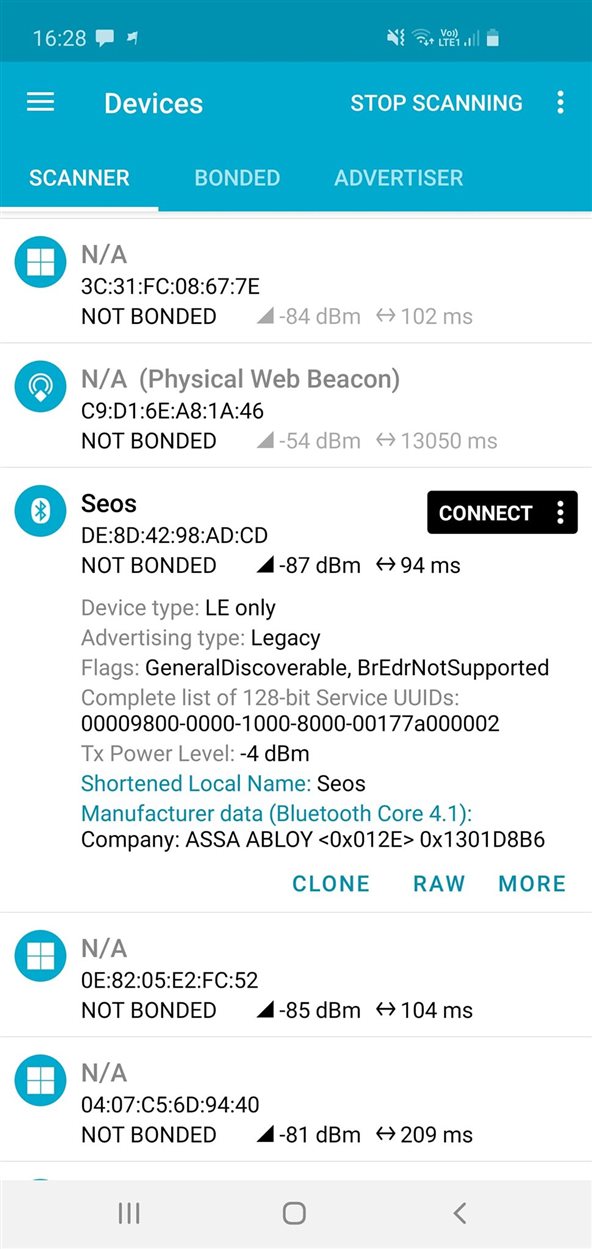

when I kept on trying to advertise multiple services.In one way I was able do it.i.e I simply added services to m_adv_uuids and set appropriate value for NRF_SDH_BLE_VS_UUID_COUNT
and changed ram start location and ram maximum size.I found that five services that I have added in globally declared array i.e m_adv_uuid are able to advertise and scan on nRF Connect for mobile.
Then when I was rechecking the code I found that there is also locally declared m_adv_uuid with one service in it.I just commented it out and then tested again application then I was stuck with an error12.Again if I remove comment and check its working status then again it is able to advertise all the services which were declared globally.The below are the code snippets.

Can you please let me know if the approach that I have implemented is correct or not?In this way I am able to make services available at a time to the user.But unable to understand what that locally declared variable is doing internally.
I even tried by changing solicitated variable with uuids_complete and uuids_mre_avaiable.I was getting same Error12.
