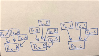

    I will be building a wireless motion alert system and will want many groups of sensors in the same area. Each Rx will probably have 2-4 Tx’s that will communicated with it. I would need ~10Rx units each on their own channel and each Rx would have 2-4 Tx modules associated with it. Ideally I’d like to use more channels in the future if needed and I assume there is no maximum number of Tx’s that I pair with an Rx.
    Thanks, I’ll take a look at the nRF52810. I don’t need long range, just 50ft max range outdoors and line of sight. Given the additional info I provided about number of unique channels required, standby Rx current, and range, do you still suggest the nRF52810? Thanks for your time.
    The system will look something like this but instead of three Rx modules each on their own unique channel there will be ~10:

     Then a BLE connection does not really make any sense. I suggest you use either the ESB protocol, see; Enhanced ShockBurst User GuideEnhanced ShockBurst API docs, and the ESB Low Power Transmitter/Receiver Example,
    or the Radio Transmitter Example and Radio Receiver Example
    The ESB protocol has some neat features like ACK'ing and automatic re-transmissions, channels selection, etc, but it only supports 8 transmitters per receiver, unless you do some hacks to it.
    Each radio has a unique on-air address that you can use to determine what transmitter sent the received packet.
