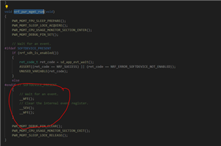

    The correct way would be to use SYSTEM ON sleep also known as IDLE sleep. This is implemented in most of our BLE examples in the SDK. The current draw in IDLE sleep depends on your specific application (what peripherals that are enabled, state of GPIOs etc). IDLE sleep is implemented in our BLE examples by calling nrf_pwr_mgmt_run() which again calls the ARM functions WFE() and sets the CPU in IDLE until a interrupt is generated.
