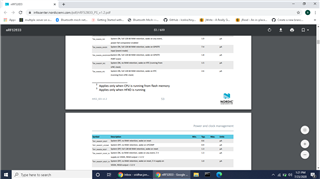

Hi Stian,
Thanks for the information but we would like to know
ION_RAMON_EVENT
ION_RAMON_EVENT is the same as System ON idle. In system on idle the the WFE (Wait For Event) has been called, so the CPU is in IDLE mode, and waking on any event (interrupt).
This will give you the ION_RAMON_EVENT current:
int main(void){
for(;;){
__WFE();
ION_RAMON_GPIOTE (waking on the GPIOTE IN event):
#define PIN 13
int main(void){
NRF_GPIO->PIN_CNF[PIN] = 0xC; //input, pullup
NRF_GPIOTE->CONFIG[0] = 1 | (PIN << 8); // configure IN event
for(;;){
__WFE();
ION_RAMON_GPIO (waking on GPIO PORT event)
#define PIN 13
int main(void){
NRF_GPIO->PIN_CNF[PIN] = 0x3000C; //input, pullup, sense low
for(;;){
__WFE();
}Hi,
