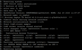

When I try to run a project containing a .cpp file, I get the following console output:
I am compiling the openthread client example with a slight modification. So far the only difference between the ncs openthread example and my project is that I have created a main.cpp file which calls main() instead of calling main() in coap_client.c. If I change the file extensions to .c it runs normally. Why is this? CONFIG_CPLUSPLUS is enabled in the prj.conf file. The same behaviour happens with the coap_server.c example.
Also, the two following errors always occur, even when running the example without any changes:
E: Timeout while waiting network interface
E: Network initialization failed (-115)
What does this mean?

    I am not able to reproduce your problem when using C++.
    Here is a diff showing my modifications:
     Do you have two DKs, where the other one is running the coap_server sample?
    Didrik
  • Hello Didrik,
    After updating the SDK to the latest revision, the MPU fault problem no longer occurs.
    The timeout and initialization errors are still present. However, they do not seem to cause any particular trouble for the application. And yes, I am running the server example on a different evalkit., but I do not think this is relevant for this error log since it occurs under initialization - whether or not another evalkit is running the server/client example.
