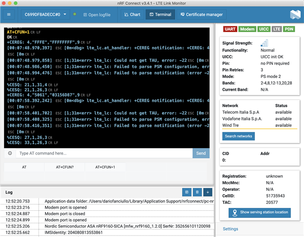

I tried connecting the thingy91 out of the box and it was working fine, sending data to nrfCloud.
Now I tried to build the asset tracker application on my own and seems it cannot connect any more.
Build was successful, I made only a few slight changes in the code and I set up in prj.conf LTE n and NBIOT y as here it's the only one supported.
Here is the lte link monitor screenshot:
Any hint?

  • Hello Dario,
    Can you please provide a full output log from the LTE Link Monitor as your screenshot shows very little.
    What version of NCS are you running? Are you using iBasis SIM provided with the board?

  • Hi Øyvind,
    Yes, I'm using the iBasis SIM bundled with the board and I checked out the v1.3-branch.
    Please find attached the full Link monitor output.

  • According to our developers, the lines with error relating to PSM has been fixed in this PR.
    2020-07-23T10:53:00.250Z DEBUG modem << [00:00:52.955,596] [1;31m<err> lte_lc: Could not get TAU, error: -22[0m
    2020-07-23T10:53:00.259Z DEBUG modem << [00:00:52.962,188] [1;31m<err> lte_lc: Failed to parse PSM configuration, error: -22[0m
    2020-07-23T10:53:00.268Z DEBUG modem << [00:00:52.970,214] [1;31m<err> lte_lc: Failed to parse notification (error -22): +CEREG: 2,"FFFE","FFFFFFFF",9
    Please update the master branch and check out NCS 1.3 one more. Remember to run west update when returning to NCS 1.3
    Regarding the connection issues, what changes did you do to the application?
