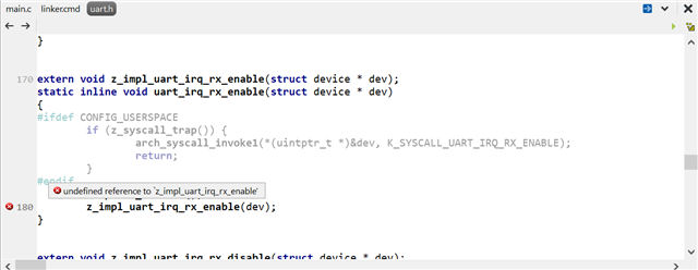

RTT Viewer only shows logs when main thread in nRF9160 is sleeping
I am using the Thingy:91 PCB and I have disabled the nRF52 by cutting SB4 and soldering SB3. This makes me unable to log through UART. For this reason I implemented RTT logging and it has been successful with the exception that messages are only printed on the JLink Viewer when my main thread in my application sleeps.
I would like to know if that is a normal behaviour or not, I could not find any information related to it.
I think you might want to see the proj.conf that I am using:

Aleix
  • Hi!
    Could you provide the file <build_folder>/zephyr/.config that appears after building?
    Also, you can try this combination of configurations to see if it fixes the issue:
    CONFIG_CONSOLE=y
    CONFIG_RTT_CONSOLE=y
    CONFIG_USE_SEGGER_RTT=y
    CONFIG_LOG=y
    CONFIG_UART_CONSOLE=n
    CONFIG_SERIAL=n

    Then I changed the .config file as you suggested, but got a compilation error:
    Aleix
  • Hi, yeah I came to the same realization.
    I'm sure there are other options though.
    On Monday, there are a lot of people returning from vacation and I can get you a better answer as to what you need to do to fix your issue.
