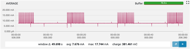

System ON sleep mode problems (sometimes ~500uA draw, sometimes ~7.5mA draw), with logging and debugging disabled
Hello, I am using nRF52 DK and SDK V15.2.0 with a Nordic PPK to measure current draw. I have read tons and tons of questions posted here but am still unable to figure out what is going on with my application. I have implemented a protocol as follows:
- read some sensor data with SAADC
- turn off SAADC/gpiote/etc
- advertise for 5 seconds
- After connection and sending of data, or timeout, wait for 10 seconds with app timer
- repeat (read data, turn off peripherals, advertise)
I would like my device to enter low power sleep mode during the 10 second waiting period between reading data/advertising. However, I am finding that the device only enters system ON "low power sleep mode" once, and then always returns to a high power mode. As you can see in the attached graphs, the first iteration of this protocol is relatively low power (~500uA draw) throughout advertising and the app timer. However, when the timer ends and data reading/advertising occurs again, the device begins to draw ~7.5mA. The device never returns to the low power state of 500uA draw. Even if I power cycle my nRF52 DK, it remains in the 7.5mA draw range.

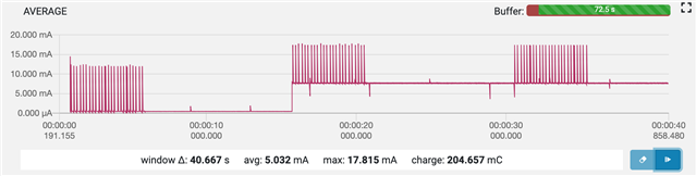

500uA is seen in the start, then 7.5mA is seen in the consecutive iterations of the protocol:
Even when I power cycle the DK, once it enters the 7.5mA draw it never goes back to 500mA (even if I power off, shut down power profiler app and reopen again):
My protocol for flashing and testing power is as follows (I have SB9 cut):
- Connect jumper across current measurement pins and connect DK to my mac
- Flash the softdevice and application hex files using nRF connect, erasing the chip before flashing occurs
- Power off DK, remove jumper across power measurement pins, and connect power profiler board
- Open up the power profiler program in nRF connect, turn on the DK, then select the board
- Program the PPK when nRF connect asks, then begin monitoring current draw
The nRF DK only is in the 500uA draw range during the first iteration after flashing the code. Once it begins to draw 7.5mA, this never changes even if I power cycle the DK and reconnect/reopen the power profiling app. I'll attach my complete main.c and sdk_config.h below, however I use the following general method to enter low power system ON mode, with nrf_pwr_mgmt_run:
