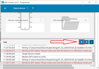

I have setup my new Thingy91 and got it connected to nrf Cloud.  I can see environmental sensor data in the terminal window but it is asking me to update the modem firmware to see services etc.
When I try and use nRF connect Programmer to update the modem firmware via USB it fails each time with the error message
"MCUboot DFU failed. Please make sure that the device is in MCUboot mode and try again."
I am powering up the device with SW3 pressed and I have the option ticked for MCUBoot.
Can you suggest what I should try next as I am not sure which application/firmware is working or not working and how to get the system updated to the latest firmware.

2020-07-24T10:10:53.563Z INFO Modem DFU starts to write...
2020-07-24T10:10:53.563Z INFO Writing /Users/michaelpyott/Desktop/Thingy91/thingy91_fw_2020-04-29_bc7ade8b/mfwnrf9160120.zip to device
2020-07-24T10:10:54.020Z ERROR MCUboot DFU failed. Please make sure that the device is in MCUboot mode and try again.
