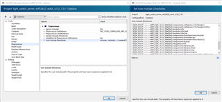

    Add the following folders to the project include path of the nRF5 SDK example
     You can add the needed folders in the User include directories;
    Select your project -> Go to project -> Options -> Select Preprocessor and add the folders to the User include directories.
    I suggest that you take a look at the tutorial series that I linked above. It contains a lot of useful information about how to use the nRF5 SDK with SES.

  • This error comes from nrf_mesh_config_app.h, in the first lines of code:
    #ifndef _lint
    #error "This file should be copied, not included."
    But I cannot find where _lint is defined or set.

    And regarding the optional changes
    Also, go through the "Optional changes" in the document.
    - I just tried to follow the tutorial step-by-step, I didn't skip anything and that is why I have not reached that part yet. But now that you suggested, I went through it and to be honest, I have no idea which of those optional changes applies to me. I did this part, however, like you suggested me:
    Copy it from the examples/templates folder in mesh stack repository into your project folder, and remove #error message at the top of the file
    But now there are new errors.
    If you have any new leads, I'd be grateful.
    Thanks!
