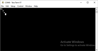

I have not encountered any issues with this so far, the program compiles without errors and is able to connect to the central without issues.
On the central nRF52840 DK, I flashed the device with the ble_app_uart_c example without changes. With this setup, I was expecting to receive the sensor value on the central side, but all I get is random characters (shown in figure below).
I looked everywhere to get an idea of why this is happening, but I cannot understand the reason.
Would be great to know why!
