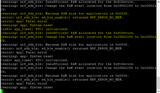

error 1 if try to change NRF_SDH_BLE_GATT_MAX_MTU_SIZE

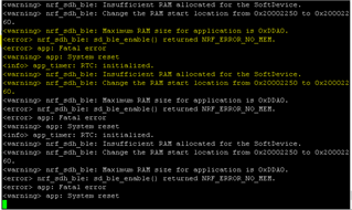

error 2 if try to change NRF_SDH_BLE_VS_UUID_COUNT
