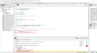

1. In the ssdk:ncs v1.3 Example: in 10_hello_world_clock_gettime, test function: clock_gettime (CLOCK_MONOTONIC, last_action_time);
The following error occurred at compile time:
You need to add this to your prj.conf:
CONFIG_POSIX_CLOCK=y
