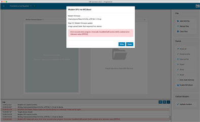

Just received the Thingy91 and trying to upgrade the model firmware to v1.2 but it fails like this:
However I successfully been able to flash the modem firmware v1.1.3.
On the box, the device sticker says: Thingy91 1.0.2 2020.13
What should I do to fix this please?
Thanks
EDIT:
The issue happens with the mfw_nrf9160_1.2.0.zip file, however it worked with the fw mfwnrf9160120.zip provided in the thingy91_fw_2020-04-29_bc7ade8b.zip
