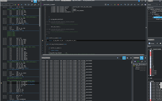

timeslot radio callback not occur after advertising stops
Radio callback not occure after advertising stops.
I changed ble_app_beacon example to support timeslot as follows.

I put "NRF_LOG_INFO("radio_callback:%d", signal_type);" at radio_callback function.
And I changed advertising duration as "m_adv_params.duration        = 1000;" for 10 sec.
For first 10sec, text of "radio_callback" is printed out to terminal correctly.
But after that,  text is not so frequently (it means every 3sec or more long).
Could you explain how this happen?
Timeslot radio callback is effects RADIO activity of softdevice?
