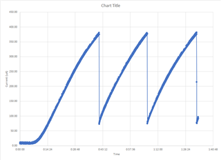

I am facing the issue with sleep current in nrf51822. initially i checked the sleep current 11uA. but after one hour it is increasing to up to 390 uA gradually.
here i have placed sleep current variation graphically.

  • This sounds like a floating input GPIO. Make sure that all inputs either has the input buffer disconnected (PIN_CNF[n] = 0x2), or that the input is at a defined level. You can check all the PIN_CNF registers, and if some of them are configured as input, and has the input buffer connected, without any internal pull up or pull down (0x0) then the GPIO has to be driven to a logic high or logic low externally.
