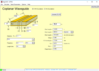

    I am trying to use the same bluetooth antenna provided in the nRF52840 dongle reference design. When I open the given hardware files, the substrate definitions and the microstrip dimensions are:
    Dielectric - 4.8
    h - 78.74 mil
    trace width - 10 mil
    Therefore, I wanted to make sure these same dimensions are preserved, otherwise it is going to affect antenna matching. If there are any further details on the nRF52840 Dongle subrate material please share with me.
