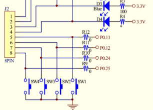

The example uses SW3 and SW4.  Pressing SW3 on the MDBT50Q-DB-33 does work to make the device go into tho the tester mode.  Unfortunately, pressing SW4 does not make the device work by using the BOARD_DUMMY_BUTTON when defined as BSP_BUTTON_3.
According to the schematic provided by Raytac, SW4 should be connected to P0.25, which is the same as the nRF52833 DK.
MDBT50Q-DB-33 schematic switches

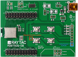

To investigate if the switch was changing state when pressed, I hooked up a Logic Saleae Analyzer to the pin labeled as P0.25 (which should have been J3, pin 13) and pressed the button.  I could not see the state of pin change.  I checked all of the other switches and could see that they were high until I pressed on the switch, at which point the line would go low.  I then checked with a meter and found that SW4 appears to be connected to pin 14 of J4 which is marked as a NC (this should have been connected to P0.25).

I changed the BOARD_DUMMY_BUTTON to BSP_BUTTON_1 and reloaded the firmware onto one of the boards.  I was then able to press SW2 and get the example to run.
I have reached out to Raytac and asked them to review this.
