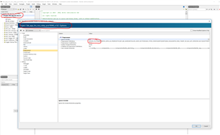

The board file is included in the relay example indirectly by the inclusion of the bsp_btn_ble.h header file which again is dependent on bsp.h which again is dependent on boards.h. You have to remove the PCA10040 from the preprocessor definition and replace it with PCA20020. You also have to map any other pin that is used by the relay example and not mapped in the board file correctly.
This might not be easy if you have limited experience with the SDK but it should be manageable with enough time and effort.

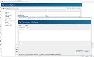

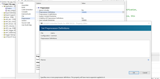

I looked a bit online how to do this and I understood that it's achievable using SES. However, in my pre-processor definitions, it's empty (from my understanding, there should be a PCA10040 definition already). Like you may see below.
Do you have an idea if this is correct & how I should add the PCA20020 definition? Thank you in advance!
