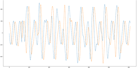

does anyone tried terminated vs unterminated RF switch in AoA / AoD application? According to forum, some people use terminated switch, some don't.
Also, there should not be any DC level, but someone form nordic recommended to use DC blocking cap:
https://devzone.nordicsemi.com/f/nordic-q-a/57001/we-make-a-board-for-nrf52811-drection-finding-can-it-work
My problem is that i'm getting wide spread of phase shift from the same place, so im looking for the origin of that issue.

  • Yes, i see phase shift in static enviroment. Even in the middle of the garden, where there should be not much reflections.
    Here is how the IQ data look like:
    Here is the gif from data processing. Im able to compensate all data and don't see there any reflected signal.

    Our current RF switch in unterminated BGS13SN8E6327 without blocking caps.
