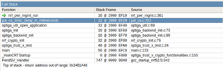

Migrating OPTIGA TRUST I2C PAL from nrf_drv_* to nrfx_twim causes nrf_pwr_mgmt_run to not return
I am currently testing Optiga Trust X using an NRF52 DK. I am using armgcc as my toolchain.
The example provided by the nRF5 SDK v17.0.0 is a great starting point and I was able to fully test the Optiga functionalities.
Now, I am integrating the Optiga Trust X libs with my product codebase. So far, I have already included the required macros in the sdk_config.h, added the files to the makefile, got a successful compilation and run the code. However, to do so, since Optiga Trust X I2C Platform Abstraction Layer (PAL) provided by Nordic uses the legacy TWI drivers and the twi manager, I needed to remove my code that uses the nrfx_twim driver. Otherwise the application of the nrfx_glue and legacy porting layer messes up compilation by defining the legacy drivers and undefining the nrfx so much that I cannot get an executable.
As far as I am aware, nrfx_twim cannot coexist with nrf_drv or nrf_twi_mngr, so I started porting the I2C NRF PAL to use only the nrfx_twim. The port was apparently successful, since the code compiles, but when running the code, it gets stuck __SEV(), on nrf_pwr_mgmt_run call, on line 361 of nrf_pwr_mgmt.c, which contains:
// Wait for an event.
__WFE();
// Clear the internal event register.
__SEV();
__WFE();
My port of the to the nrfx_twim is attached below. Please note that I am using a blocking call, but have also tested using a non-blocking call with a twim_handler and it causes the same result. The call stack is in the following image.

I have two questions:
1. Is not possible to use, on the same application, nrf_drv_ + nrf_twi_mgnr and a nrfx_twim drivers, even if the former controls the TWI0 and the latter the TWIM1, correct?
2. Why am I getting stuck on the pwr_mgmt_run routine and what can be done to fix it?
Pedro
