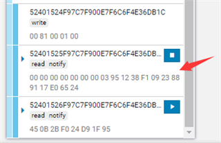

   I am testing sending and  receiving data  between nRF51 dongle and peripheral by example of heart-rate-collector.
   now I could find characteristics I need(write, read/notify).
   I already know using sd_ble_gattc_write() to write data, but  how could I read data from other characteristic, which method i can use ?
