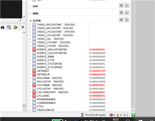

To the kind attention of Nordic support team,
I need to disable, enable gzll more times. When enabling it, code gets often stuck in my case as in figure: nrf_impala.c 442. What could be?
Is it possible for you to say what could be the cause, having access at gzll source code? Thank you for your kindness
    It looks like it is stuck trying to start up the HFCLK.
    Is this consistent behavior on your end? Could you try stopping the HFCLK before re-starting gazell, just to see if the behavior changes then?

  • Hi, thank you very much for replying us. Sorry, I have a doubt, are we talking about HFCLK or LFCLK? I'm asking because in your sdk16 multiprotocol ble_app_gzll you are using:
    // Request Low frequency clock to re-enable the clock after the softdevice stops it.
    err_code = bsp_indication_set(BSP_INDICATE_IDLE);
    // Enable Gazell.
    gzll_app_start();
     .. And then
    nrf_drv_clock_lfclk_release();
    // Disable Gazell.
    gzll_app_stop();
    // Re-enable the softdevice stack.
    ble_stack_start();
    ble_hrs_app_start();
    I'm also using in this case a Raytac module, nRF52833 based, and modified sdk_config.h so to have RC as a base for LFCLK. It seems also lfclk_stop is failing sometime, and as you point out this could be related to the issue in re-starting gzll. Also this prevents to re-enable softdevice as sd_softdevice_enable gets stuck as well. In the following pictures there is the situation before calling sd_softdevice_enable, and when it is not working LFCLKSTAT is different. I'll try to see what are the differences in the project I modified with respect to your multiprotocol example. If you have any suggestions, will be more than welcome. Thank you for your work
    It looks like its stuck trying to start the HFCLK (not the LFCLK), based on where its stuck in nrf_gzll.
    Do you have any issues using the device, ie: communicating to it over bluetooth / gzll? If there's problems with the external crystal, the softdevice will run on HFINT (very imprecise) and you will not be able to use the radio properly.
