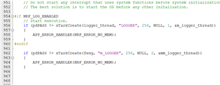

#if NRF_LOG_ENABLED // Start execution. if (pdPASS != xTaskCreate(logger_thread, "LOGGER", 256, NULL, 1, &m_logger_thread)) { APP_ERROR_HANDLER(NRF_ERROR_NO_MEM); } #endif here ,look,this is example…

you probably have run short of heap and xTaskCreate failed with error NRF_ERROR_NO_MEM. Increase the heap size configTOTAL_HEAP_SIZE in FreeRTOSConfig.h file

yes, I Increase the heap is oK, thank you
