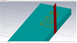

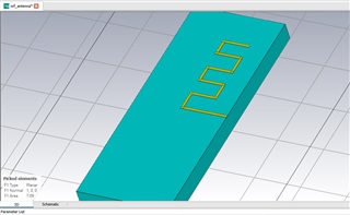

I am trying to simulate the nRF52840 Dongle Antenna given in the hardware files using CST studio. I am using the following substrate and trace width which was in the hardware PCB files.
FR-4 - Dielectric 4.8
h = 78.74 mil
Antenna microstrip trace width, w = 10 mil
I first wanted to simulate the antenna section starting from the RF feeder (left of the green arrow) as shown below.
My CST design is as follows. There is no ground plane because it is a monopole antenna.

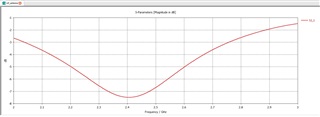

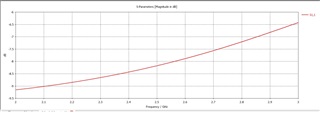

As you can see from the above images, my simulation results are really bad.
1. I am thinking it could be because of my port settings in CST. If so how can I assign ports to such an antenna CST?
2. Are there anything else I am doing wrong here? I am thinking that I should see little bit of matching at 2.4 GHz without the matching network. But it looks like there is no resonance at all at this frequency.

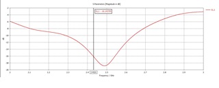

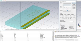

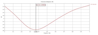

    In my above simulation, it does not have a ground plane. This is the reason why the results were wrong. In the nRF dongle, RF feeder line width is 35 mil which I think had calculated as a CPW. So I added a feeding CPW Microstrip line to the antenna with width 35 mil. Now I am getting some what sensible result, but the return loss is still not very good yet.
    Below please see the images of the new port configuration and the results. Any idea what I am doing wrong. I am also getting some warnings while running the simulation.
    Thanks!

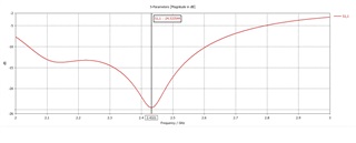

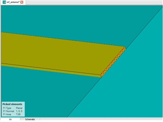

    Further note, I did a simulation including the entire ground plane according to the chip size. I also had to include the CPW feeder that connects to the ground. I was able to get a better result now.
    However, If I don't include the CPW feeder I get bad results. I am not sure why this is so. Also Waveguide port dimensions have significant effect on the response as well. Please see the attached images.
    Thanks!
