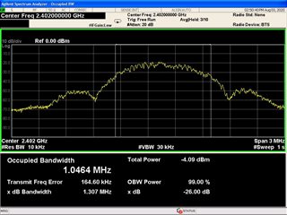

Hi.
Development platform : nRF52833-DK, s113, SDK 16.0.0, IAR 8.31.1
I am in the process of RF certification.
I downloaded the example at "nRF5_SDK_16.0.0_98a08e2\examples\dtm\direct_test_mode" directory.
Use the Direct-Test-Mode program of nRF-Connect-v3.4.1.
A problem occurred in which the center frequency was moved outside the margin of error as shown in the figure below.
What should I do to fix this?
