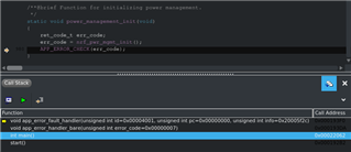

In my sdk_config.h, NRF_SDH_CLOCK_LF_SRC, NRFX_CLOCK_CONFIG_LF_SRC and CLOCK_CONFIG_LF_SRC are all set to 0 which means NRF_CLOCK_LF_SRC_RC. While the RC and Xtal lf clock options should be approximately the same (I've read 2-3% lower current draw using external lf xtal), I wanted to see if using the xtal would help at all. So, I change the sdk_config.h clock settings to 1 which means NRF_CLOCK_LF_SRC_XTAL. However when I do this, my application no longer runs and instead breaks with a fatal error. I have not changed the default configurations of SB1, 2, 3, and 4 on the nRF52 DK as they are by default setup to use the external xtals. I have also disabled all logging defines in my sdk _config.h as well as backend_rtt. Attached is a screenshot of the error, which is thrown when I check the return code from "nrf_pwr_mgmt_init()":
The error code is 0x7, and then the id is 0x4001. Error 0x7 indicates incorrect parameters, but the function doesn't even take any parameters. I think this could be unrelated to the power draw issue, but it is strange that when I set my lf clock source to xtal I get this behavior. I have tried calling "nrf_clock_lf_src_set()" in main, passing the xtal as the parameter, and this does not cause any error. However, the current draw stays the same.
