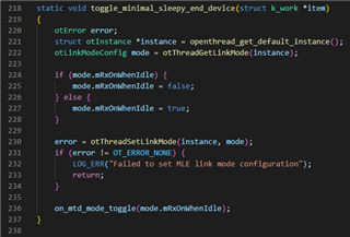

I am currently running the openthread client example provided in the NCS and I am trying to toggle the client as a sleepy end device. However, in the toggle_minimal_sleepy_end_device() function, otThreadSetLinkMode(instance, mode) returns OT_ERROR_INVALID_ARGS and "Failed to set MLE link mode configuration" is thus logged to the console. I have added
CONFIG_OPENTHREAD_MTD=y
CONFIG_OPENTHREAD_MTD_SED=y
in the prj.conf file as explained in https://developer.nordicsemi.com/nRF_Connect_SDK/doc/latest/nrf/ug_thread_configuring.html, and the client is correctly initialized as an MTD (child) and does not become either thread leader or router.
I have also the same with the server example, but the same thing happens there as well when calling toggle_minimal_sleepy_end_device().
For the record, the instance pointer returned from openthread_get_default_instance() in toggle_minimal_sleepy_end_device() is not NULL, and the booleans in the mode bit field returned from otThreadGetLinkMode(instance) evaluates to true, false, true, true - respectively. Thus, mode.mDeviceType indicates that the "sender" is an FTD, which i reckon is the problem here.
Is there anything else I need to do regarding the configuring?
And there is one more thing: When adding the two prj.config lines shown above, the client is not able to send unicast messages to the server. Multicast works as before. That is, I am able to provision the device as before, receiving the IPv6 address of the server, but when trying to send a message, the device halts and needs a restart. Why is this?

  • Hello Edvin,
    See attachment below.
    This function is correctly submitted to the work queue and called when enabling CONFIG_OPENTHREAD_MTD_SED. However, the if statement on line 231 evaluates to true because otThreadSetLinkMode() returns OT_ERROR_INVALID_ARGS.
    See attachment below for declaration of otLinkModeConfig struct returned from otThreadGetLinkMode() on line 222:
    The fields of this struct are true, false, true, true (1, 0, 1, 1) when passed to otThreadSetLinkMode(). I reckon the third field, bool mDeviceType, should be false?

    So I tested the unmodified coap_client example from NCS, and at first I also saw the "Failed to set MLE link mode configuration", but I did an nrfjprog --eraseall, and the issue went away.
    Can you please test this? If that doesn't work, I am running on NCS v1.3.0, can you please test that tag? The master may or may not work, based on when you fetched it.
    Edvin
    Indeed, it looks like the SED call succeeds on tag v.1.3.0. It still fails the latest release of the master branch. Do you know how the power management is handled for the SED's on tag v1.3.0 compared to the latest release? The toggle_minimal_sleepy_end_device() function is updated with power management features on the master branch.
