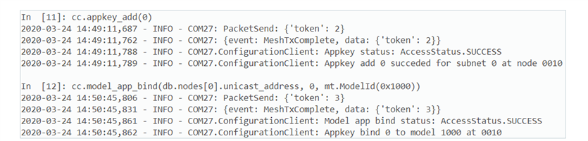

  • Can you just post the whole thing before and after you type cc.model_app_bind ?
  • python interactive_pyaci.py -d /dev/ttyACM0
    db = MeshDB("database/example_database.json")
    db.provisioners
    p = Provisioner(device, db)
    p.scan_start()
    p.scan_stop()
    p.provision(name="Light_Bulb")
    cc = ConfigurationClient(db)
    device.model_add(cc)
    cc.publish_set(8, 0)
    cc.composition_data_get()
    cc.appkey_add(0)
    cc.model_app_bind(db.nodes[0].unicast_address, 0, mt.ModelId(0x1000))
    gc = GenericOnOffClient()
    device.model_add(gc)
    gc.publish_set(0, 0)
    gc.set(True)
  • Please, I want to see also the response from PyACI when you type those commands. Please copy everything. Something like this:

    2020-08-07 22:31:46,275 - INFO - ttyACM1.ConfigurationClient: Appkey status: AccessStatus.SUCCESS
    2020-08-07 22:31:46,279 - INFO - ttyACM1.ConfigurationClient: Appkey add 0 succeded for subnet 0 at node 0011
    In [12]: cc.model_app_bind(db.nodes[0].unicast_address, 0, mt.ModelId(0x1000))
    In [13]: 2020-08-07 22:32:16,030 - INFO - ttyACM1: PacketSend: {'token': 3}
    2020-08-07 22:32:16,060 - INFO - ttyACM1: {event: MeshTxComplete, data: {'token': 3}}
    2020-08-07 22:32:16,087 - INFO - ttyACM1.ConfigurationClient: Model app bind status: AccessStatus.INVALID_ADDRESS
  • As you can find at line 30 you have the address 0x11. This meant there was another node provisioned before the node you posted.
    Then when you do cc.model_app_bind(db.nodes[0].unicast_address, 0, mt.ModelId(0x1000)) it will try to bind the application key to the model on the db.nodes[0].unicast_address address. This address is most likely 0x10, not 0x11. And if there is model 0x1000 on this element (0x10) then you will receive invalid address.
    Please either use db.nodes[1].unicast_address (or use the actual address that matches your node in this case 0x11) or check the example_database.json and remove the provisioned node (you can use the backup file). Then try again.
