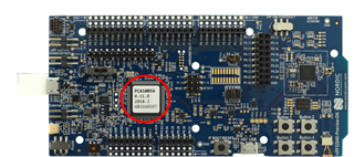

Tu exclude my HW-FW, I tried same test using PCA10056, Nordic_Blinky sample from nRF5_SDK_16.0.0_98a08e2.
I have same result: if you try to repeat connect/disconnect/connect ... and so on , the module stops and it need to restart to make it working.

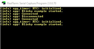

    I sent you the capture log from serial channel.
    With this code, when lock occurs, after HW reset of DK board reset the advertising starts but I'm not be able to re-connect the device.

    <info> app_timer: RTC: initialized.
    <debug> nrf_sdh_ble: RAM starts at 0x20002300
    <info> app: Blinky example started.
    I see that this log was uninformative aswell. I will bring this on internally!
