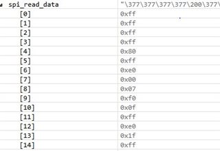

I have a SPI Peripheral connected with nrf52832 EVK to check working of SPI interface.
I am writing a 10 bytes of data to a specific address and read back from specific address. (loopback)
But this is not working fine. I am receiving some junk values.
Kindly help me to solve the above problem.
Hardware: nrf52832 EVK with SPI IC (W25Q80DVSNIG)
Software used : nRF5_SDK_16.0.0_98a08e2\examples\ble_peripheral\ble_app_uart\pca10040\s132\ses
SPI Configuration as shown in below:

Output: Junk values ( Attached output with waveform )

Meghana
  • Hello Meghana,
    nrf52832 EVK
    Are you here referring to the nRF52832 DK? I am just asking to avoid making any wrong assumptions.
    By this, I assume you mean that you are working out of the ble_app_uart example, with the addition of the SPI code.
    Which SPI example have you used as you reference here?
    I would recommend that you make use of the nrfx_spim driver directly, since the nrf_drv_* drivers are legacy.
    Could you perform another test where you use SPI mode 3, instead of 0, and let me know what the results are?
    Karl
    Yes I'm referring nRF52832 DK and using same DK to bring up the peripherals with ble_app_uart example code along with nrf_drv_spi(legacy) drivers and also I tried with the spi mode 3. But the issue is same as previous mail that i have already sent you.
    I am receiving junk values (some bytes are having proper data and some bytes are junk)
    kindly help us to solve the above issue..
    As u said in last mail i will check with nrfx_spim driver and will let u know the results of it.
    Note: Initially i worked with nRF52810 DK with the software ble_app_uart along with same SPI IC (using nrf_drv_spi legacy drivers) Its working fine.
    Meghana
