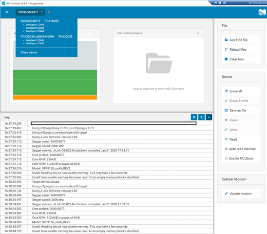

How to verify which device - Thingy:91 or onboard 9160 - is connected to the Segger JLINK probe on the nrf9160 DK?
I may be stupid, but I cannot find any indication of which device is currently handled by the nrf9160 DK probe in the nRF Connect Programmer or Segger IDE.
As far as I can the same serial and model numbers are displayed no matter if the probe is handling the external Thingy:91 or the onboard  nrf9160 DK.
See the picture, both devices connected, and JTAG cable between Thingy:91 and nrf9160 DK .
Current the Thingy:91 is connected and displayed. But I only know this because of the memory map, being of the code currently in the Thingy;91
Clicking the info (i) button displays the serial number of the DK nrf9160, not the Thingy:91
So how can one verify that the correct device is being programmed and debugged?
    Not stupid at all. Quite a common scenario here as well.
    I usually program my nRFxx-DK with blinky, then connect another board via the "DEBUG_OUT" port.
    Issue a "nrfjprog -e"; if your DK stops blinking, you're not targeting the correct board ;)
    Another option is to read a unique register (ex. DEVICEID in FICR), or cut the solder bridge for current consumption measurement on the DK (remember to add a jumper wire or similar afterwards!).
