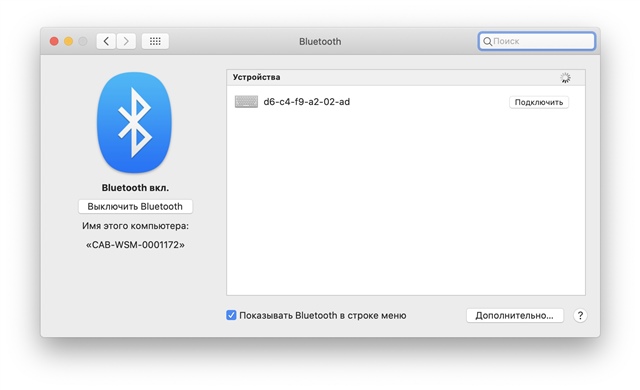

Firstly, most of the time MacBook Pro shows address instead of a device name.
Then I try to connect MacBook Pro to nRF52840 DK and it looks like connected, but round progress bar icon on the right side from Bluetooth address spins all the time.
Connected 38:f9:d3:ea:48:5c (public)

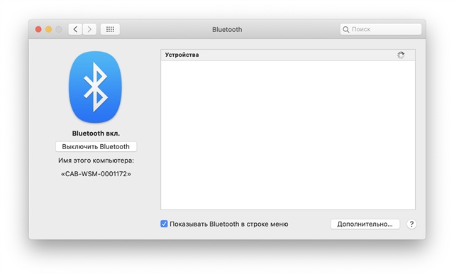

And there's not pairing stage after it. And after a while, this device disappears from the list of devices completely, but there's nothing new in UART log from nRF52840 DK.

  • Thanks for your answer! It's great that you figured out an error. Should I fix NCS HID keyboard example somehow to provide encryption? And could you point me out how to do it?
  • No problem! I'm looking at some way to fix it, but can't manage to finish before weekend. I will look at it again on Monday and get in touch with the NCS team as well.
    I'm not entirely sure on how to fix it exactly, but it seems to be an issue with the MAC not sending a passkey to recject/accept.
    Have a good weekend,
    Carl Richard
  • Hello again!
    I figured out the issue and have a fix ready for you :)  Just add the following line to your prj.conf:
    CONFIG_BT_GATT_HIDS_DEFAULT_PERM_RW_ENCRYPT=y
    Hope it works for you!
    Carl Richard
