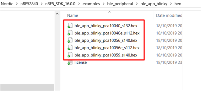

    However, what it is not clear for me is that, I didn't required to upload the softdevice seperately. Looking e.g. the hex file of the blinky project in ble_peripheral examples, I can see the title of each hex file includes the softdevice. What is happening here? The generated hex files of Nordic's examples includes the softdevice? I mean maybe the linker merges application's hex file with softdevice's hex file?
    I believe that Nordic is trying to reduce complexity for developers who are getting started with Nordic devices and the SoftDevice.  All of the BLE examples have the SoftDevice included and the SES projects have the SoftDevice loaded for you.  You can find this if you review the .emProject file.
    I have created scripts which merge the SoftDevice, bootloader and application hex files into a single hex file for production.
