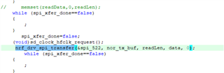

When SPI sending data, sometimes there are only seven signals.
SDK_16.0.0.

Try this after init:
APP_ERROR_CHECK(nrf_drv_spi_init(&spi, &spi_config, spi_event_handler, NULL));
// Boost drive to MOSI and MCLK to sharpen clock edges and timing
nrf_gpio_cfg(RC522_SPI_MOSI_PIN, NRF_GPIO_PIN_DIR_OUTPUT, NRF_GPIO_PIN_INPUT_CONNECT, NRF_GPIO_PIN_NOPULL, NRF_GPIO_PIN_H0H1, NRF_GPIO_PIN_NOSENSE);
nrf_gpio_cfg(RC522_SPI_CLK_PIN, NRF_GPIO_PIN_DIR_OUTPUT, NRF_GPIO_PIN_INPUT_CONNECT, NRF_GPIO_PIN_NOPULL, NRF_GPIO_PIN_H0H1, NRF_GPIO_PIN_NOSENSE);
The reason is likely that the logic analyser/'scope is hiding information from you, the edges are really not as sharp as displayed and the timing is too sloppy with S0S1 drive levels at 1MHz. I posted a similar response here strange-mosi-behaviour-on-spi2
Thank you very much!Add this code , ncrease the logic sampling rate ,That's not a problem right now. I'm testing it
