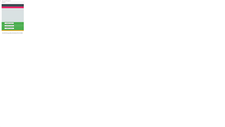

    For find the reason, I compare the map in chips by nRFConnect àProgrammertools,please to see the picture(the both DK have been erased by "nRFjprog -e" command)
    pic 1 Chip's MAP of ble_app_blinky with buttonless DFU for PCA10056
    pic 2: Chip's MAP of light-switch server with buttonless DFU for PCA10056
    As we know, The black , red and yellow areas in pic1 and pic2 is for Setting page and MBR-P, bootloader and MBR;
    Green A area is for Software.
    The ble_app_blinky with buttonless DFU for PCA10056.bin is about 25kByte
    The light-switch server with buttonless DFU for PCA10056.bin is about 137kByte
    So the Green B area of pic1 is for application.  The green B and C of pic2 is for application.
    My question is below:
    Q3: What is for the green C of pic1?
    Q4: Why doesn't pic2 have this piece which like Green C of pic1? Is it the reason which the application do not run?
    Thanks
    Di-Sheng
     Those pictures are very (!) small.
    Besides, I don't think that they contain any relevant information.

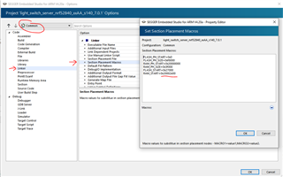

    Because only project application project (light_switch_server_nrf52840_xxAA_s140_7.0.1.hex) was modified, the rest parts such as Bootlader and Softdevice were the same as Button DFU before, and since BLE DFU was adopted, the bootloader setting page of the application was generated by bootloader, so the SES's "Section Placement Macros" of the application project do not be modified, and the contents of "Section Placement Macros"  were still as follows:
    • FLASH_PH_START=0x0
    • FLASH_PH_SIZE=0xf8000
    • RAM_PH_START=0x20000000
    • RAM_PH_SIZE=0x3f000
    • FLASH_START=0x27000
    • RAM_START=0x20002e00
     That is all I have to say about my attempt to add the Buttonless function to the Mesh example.

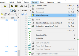

  • So LED1-4 is constant on. That is an important observation. That means that the bootloader accepts the application and start it.
    LED1-4 turned on is the error indication in a mesh application.
    In Segger Embedded Studio, which you are using, there is an option to "attach debugger":
    If you do this, it means you can debug without uploading any software to the DK, which means that the bootloader will not reject the application.
    Try this, and see if you get any log output. What does the log say? If you don't get any log output, try to add some logs in the start of the application, e.g. "start". Do you see logs before you add the bootloader?
    Either way, you can also try to set breakpoints, to see whether a function is executed or not. Where does the application stop?
    BR,
    Edvin
  • Hi Edvin
    I do debug the project follow the way that you said last post. Finally, the code  stay in " sleep_forever() " function , because  err_code =0x04 be got from "SVCALL(SD_BLE_GATTS_RW_AUTHORIZE_REPLY, uint32_t, sd_ble_gatts_rw_authorize_reply(uint16_t conn_handle, ble_gatts_rw_authorize_reply_params_t const *p_rw_authorize_reply_params));"
    The link below is the debug tracking in word format.
    /cfs-file/__key/communityserver-discussions-components-files/4/Mesh-buttonless.docx
    Q1:  Would you help me to find why it get a 0x04 error code when the "ble_dfu_buttonless_init()" be executed?  -------The error code of 0x04 was actually obtained by executing "SVCALL"
    Q2: I notice the  he light-switch server project of Mesh lacks "power_management_init()" and "gatt_init()" function compared to the BLE project. Is it mean the power_management  and gatt block do not be added in the project?
    How I can add them if they are necessary or how I can remove the checking if they are not necessary?
     If you look in your sdk_config.h file, you should see a define: NRF_SDH_BLE_VS_UUID_COUNT, which is by default set to 0. Set it to 1. When you do this, your main() -> initialize() -> ble_stack_init() -> nrf_sdh_ble_enable() will print something about changing the RAM start and RAM size.
    Now, it doesn't do that by default, because the "normal" SDK uses a different logging module than the mesh SDK, and the function that checks the RAM settings is from the normal SDK, so it will not print anything.
    So there are a few things you need to do. In nrf_sdh_ble.c, add the following things:
    #include "log.h"
    #undef NRF_LOG_INFO
    #undef NRF_LOG_WARNING
    #undef NRF_LOG_DEBUG
    #define NRF_LOG_INFO        __LOG(LOG_SRC_APP, LOG_LEVEL_INFO, __VA_ARGS__);
    #define NRF_LOG_WARNING     __LOG(LOG_SRC_APP, LOG_LEVEL_WARN, __VA_ARGS__);
    #define NRF_LOG_DEBUG       __LOG(LOG_SRC_APP, LOG_LEVEL_DBG1, __VA_ARGS__);
    Then, in nrf_sdh_ble_enable() in the same file, add \n, at the end of all the NRF_LOG_WARNING, NRF_LOG_DEBUG and NRF_LOG_ERROR calls. E.g. change:
    NRF_LOG_WARNING("Insufficient RAM allocated for the SoftDevice.");
    to
    NRF_LOG_WARNING("Insufficient RAM allocated for the SoftDevice.\n");
    Then it should say something about the RAM in your log. In my case it says:
    <t:       8299>, nrf_sdh_ble.c,  249, RAM starts at 0x20002E00
    <t:       8302>, nrf_sdh_ble.c,  252, RAM start location can be adjusted to 0x20002440.
    <t:       8306>, nrf_sdh_ble.c,  255, RAM size for application can be adjusted to 0x3DBC0.
    You need to change this in your project settings:
    Hopefully, that solves the issue.

  • Hi Edvin, I dont mean to distract your efforts to help Di-sheng, but I was worried that you didnt see my most recent comment (with all the details) up above. Basically, I got the buttonless DFU default application working as expected. However, when I add the NUS Service to the Buttonless DFU project (as shown in all my edits below, alongside enabling BLE_NUS in the sdk_config.h), the application faults after the DFU and wont actually run when uploaded to the device.
    static ble_uuid_t m_adv_uuids[]         =
        {BLE_UUID_DEVICE_INFORMATION_SERVICE, BLE_UUID_TYPE_BLE},
        //Basic default implementation from the ble_app_uart project
        // NOTE: These lines of code have been ADDED to the default implementation!
        ble_nus_init_t     nus_init;
        // Initialize NUS.
    I have also tried to "Attach Debugger" when my device is in DFU state so that I can see what happens when it fails to start my merged buttonless DFU + UART application after a successful OTA DFU. When I watch this debugger, nothing happens except the debugger quits and the Segger Embedded Studio displays the app_timer2.c file, specifically leaving the cursor at the "static uint64_t get_now(void)" function. Not sure if that helps, but I would love any tips or recommendations you have to help me merge the Buttonless DFU project with the BLE UART project. Thank you for the help :)
     No worries. I am glad you did.
    Do you see anything in the fault handler? Do you see anything in the log? Try to define DEBUG in your preprocessor definitions in your application, and monitor the log. Do you see any log messages? (Before or after the error?)

  • Hello again Edvin,
    I hope you are still able to see this response even after all this time. I have been retasked to figure out whats wrong, so I am resurrecting this thread.
    I dont see any output in the Debug Terminal at all. And when the program halts in the Debugger at the NRF_BREAKPOINT_COND; in the Fault Handler of "app_eroor_weak.c", I can see that DEBUG is defined. I notice that there is technically some output in the Debug Terminal: about 6 empty lines.
    When I "Attach Debugger", I am attaching it to the device after the device has been put into DFU mode. To be specific, I flashed the DFU Secure Bootloader example and triggered DFU mode via a push button (I also tested that it could upload a previous application image correctly before putting it in DFU mode again). While its in DFU mode awaiting my new code, I attach the debugger from the SEGGER Embedded Studio IDE. Then from my iPhone, I connect to the device, and start DFU with the prepared HEX code of my own Buttonless_DFU app code (this is a merge of the standard Buttonless DFU app which has been tested and works, along with the BLE UART example code and the TWI sensor code). From the nRF Connect app on my iPhone, the DFU process finishes and I get a little message saying that the DFU was completed successfully. However, my device never starts advertising again, so I cannot connect to it and run the application. I confirm that it is an issue with the Application Code because I am able to put it back into DFU mode and successfully upload a previous Application Image without any issues and it works as expected. So I must be doing something wrong with the merged Buttonless DFU/BLE Uart/TWI Sensor code.
    What else can I do? Is there any other option for me to Debug this? Thank you so much for your help
