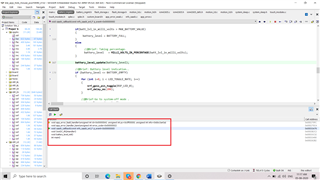

     We debugged  the code in his system and find out the reason for the device not working .Actually its due to "APP_ERROR_CHECK(err_code)".
    We  avoid the APP_ERROR_CHECK(err_code) from the function which return err_code but the issue is showing with the next function which using  APP_ERROR_CHECK(err_code) .
    NOTE:- The APP_ERROR_CHECK(err_code)  function halt the code execution only if we define DEBUG but in our project settings we are not included the DEBUG in preprocessor directives.

  • Hi Jared,
    Jared said:
    What is err_code() and what function returns the code?
     error code() is returning "2"  ie  NRF_ERROR_SOFTDEVICE_NOT_ENABLED
    please look the screen shot.
    Why this error happening in his system and not in my system? what is the reason for this ?
    please look the below code which causes this error . After we  put some  condition before APP_ERROR _CHECK the issue was solved
