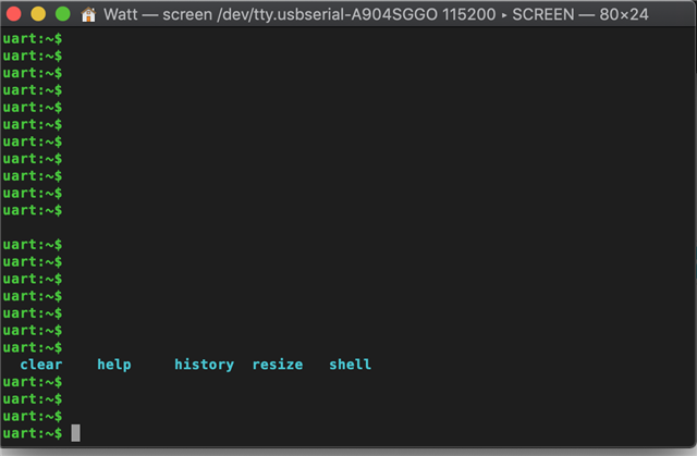

    and my prj.conf file is
    CONFIG_STDOUT_CONSOLE=y
    CONFIG_SHELL=y
    I see this
    with CONFIG_SHELL=y not set, its a black screen
