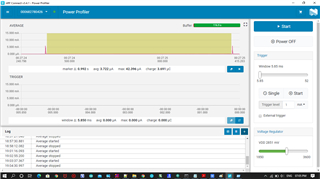

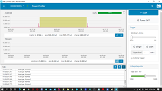

But After implementing the above code sleep current increases. kindly find below images for sleep current with and without a workaround implementation.
a) Without Workaround implementation.
b) With Workaround implementation.
