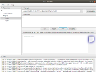

  • Last weekend I was also able to spend some time into that.
    The most challenging task seems to find a linux distribution with working bluetooth_6lowpan out of the box. On a Ubuntu 18.04 PC it works, for the Raspi OS it seems to disconnect after 30-40s.
    Using such "out-of-the-box" bluetooth_6lowpan kernels (newer than 4.12) requires then to compile the iot examples using BLE_6LOWPAN_LEGACY_MODE=0 in the sdk_config.h.
    After that it is easy as:
    sudo -s                   (enter su shell, execute the following commands in that shell)
    modprobe bluetooth_6lowpan
    hcitool lescan
    echo "connect 00:AA:BB:CC:DD:EE 1" > /sys/kernel/debug/bluetooth/6lowpan_control
    That's it, your device is connected and may be ping6ed. The ping6 response contains the IPv6 address of the device and the host. If you don't get a ping6 response from the device but only from the host itself, check, if the BLE_6LOWPAN_LEGACY_MODE is really set to 0.
    To use the iot dtls coap-server example, download the prebuild cf-client from Eclipse Releases - cf-client-2.4.1.jar
    With that IPv6 address from the ping6 just start the client on the same host running the bluetooth_6lowpan using:
    java -jar cf-client-2.4.1.jar --identity Client_identity --secret secretPSK 'coaps://[fe80::aa:bbff:fecc:ddee%bt0]/lights/led3' --method PUT --payload 2
    the out should be something as:
    ==[ CoAP Request ]=============================================
    MID    : 24288
    Token  : 1CDF1DDD4467DAD3
    Type   : CON
    Method : 0.03 - PUT
    Options: {"Uri-Path":["lights","led3"]}
    Payload: 1 Bytes
    2
    >>> DTLS([fe80:0:0:0:39:d5ff:fe9e:f2eb%bt0]:5684,ID:0E5376F5E6)
    >>> TLS_PSK_WITH_AES_256_CCM
    >>> PreSharedKey Identity [identity: Client_identity]
    Time elapsed (ms): 1352
    ==[ CoAP Response ]============================================
    MID    : 24288
    Type   : ACK
    Status : 2.04 - CHANGED
    Options: {}
    RTT    : 1352 ms
    Payload: 0 Bytes
    and the LED 3 is switching on. That takes the 1,3 s (no 3 minutes :-) ).
    Unfortunately, it's not possible to reconnect the device's server again without disconnect the ble connection. So, if you want to play more, try out the Eclipse Releases - cf-browser-2.4.1. The browser uses javaFX, which is required to be installed ahead. Start the cf-browser similar as cf-client using:
    java --module-path /usr/share/openjfx/lib --add-modules javafx.controls,javafx.fxml -jar cf-browser-2.4.1.jar --identity Client_identity --secret secretPSK 'coaps://[fe80::39:d5ff:fe9e:f2eb%bt0]'
    (that assumes openjdk java 11 on ubuntu 18.04 using openjfx)
    The UI should be easy to use. Press DISCOVER to see the resources of the devices coap-server. Select the resource lights/led3 on the resources tree on the left. select a GET to see the state, or type a 2 and use PUT to toggle the LED.
