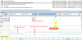

  • Hi Vidar.
    Thanks for your feedback. We are getting closer to the problem.
    Ok, your test code proves the address is resolved always, just from the beginning.
    In the attached picture you see:
    • First the button is pressed, goes to low
    • This triggers the event, the led is turned on, the GPIO signal goes to low, led is active low.
    • Now, scanning is started, the devices in the white list are searched.
    • The first triple of advertisements appears. According to your test code the address is resolved, but why is there no connection request? The device is scanning already for about 100ms. Please use the Ellisys trace for better resolution to see it better. There is also no CRC problem of the advertisements.
    • The second triple of advertisements appears. Here the connection request is sent, the central connects, the command is sent, and after this, the connection is canceled and the led is turned off.
    I think, starting the scanning will not use much time, so why is the first triple of advertisements not used for a connection?
    Because my application should have the smallest possible latency for sending the remote command, it is important for me to know, what's going on here.
    Cheers Michael
  • Hi Michael,
    Do you get a connection request to the first adv. packet sometimes, and are you starting scanning by calling sd_ble_gap_connect() or do you call sd_ble_gap_scan_start() first?
    The Softdevice should have no problem with sending a connection request to the first packet if it actually receives it. But some advertisements will be lost if you are testing in a noisy environment or if you don't scan 100% of the time (ie scan_windows != scan_interval).

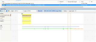

     Maybe you could double-check to see if you sent me the correct trace. I didn't find any connections in the one you sent, only advertising from the peripheral was displayed.

  • Hi Vidar.
    I have done a lot of tries and have never seen a connection request to the first adv. packets.
    I use "nrf_ble_scan_start" which calls "sd_ble_gap_scan_start".
    The environment is not very noisy and scan_window = scan_interval = 80.
    Maybe the filters are still set in your Ellisys trace, please delete the filters. You should see traffic then.
    I have also done another try: I have paired two different devices and configured the white-list to look for these two. The effect is similar:
    The advs of the first device is visible, but no connection is taking place.
    Then the advs of the second device is visible, a connection request is sent then and it works.
    This proves the address is resolved in real-time, because both devices have different IRKs.
    It looks for me like the client needs to resolve first an address and has to do some preparations to be able to resolve and connect at the next time.
    Cheers Michael
