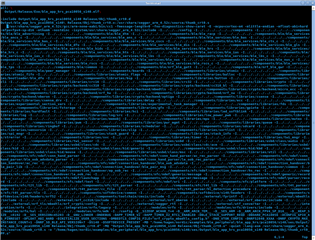

Well, a makefile can be generated but I'm afraid it is garbage. Useless. For the bin. Hundreds of lines with each over 9000 characters long. Everything with ../../../../../../. I am beginning to wonder what clueless people are writing software nowadays.... Donald Knuth was right about the percentage of good students.

Oh, another thing: the generated makefile is FAULTY. If you run it from the project file directory to accommodate those obnoxious ../../../../../../ constructs it FAILS (ble_app_hrs example).
But to be honest, that's what I would have expected already.
