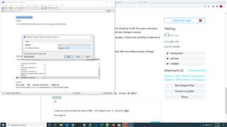

    I saw your post we have the same sniffer. I am trying to use -12, -20 and 0 dBm.
    In the menu of Wireshark just on the side of nrf sniffer 802.15.4 you will find a setting icon clicking on it will let you select the IEEE TAP please look at the image after adding this you can see the RSS in your Wireshark.

    Please see the following screenshot:
    I am sorry, but my wireshark keeps crashing when I try to save a capture, so I can't save the sniffer trace.
    Did you try to set it to -40? And when you claim it doesn't change, can you check the extended source, and verify that it is indeed from the device of which you changed the output power?
