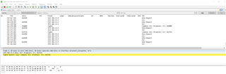

  • Do you see the RSSI of packets in wireshark (because I can't see it when I use the sniffer).

    So can you describe to me how you change, and what you see in wireshark? You may not see the difference between 0 and -12, but perhaps you can try some more extreme values and see if you see any change in the RSSI. E.g. +8dBm vs -40dBm. Can you show a screenshot of what the RSSI looks like on wireshark?

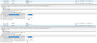

  • When you configure the nRF Sniffer in the setting right besides it you can change the channel and there is one more drop down for IEEE 802.15.4 TAP please select that it will show the RSS information. I have attached the wireshark caputre files before and after changing the power. Please have look.Capture_With_Power_Change.pcapngCapture_WO_Power_Change.pcapng

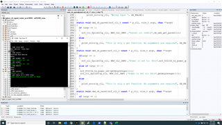

    In the Image file you can see that I am setting the power and checking it with the same command the code is just besides the terminal window. But still I cannot see change in power.
    The using a custom get data cmd I am sending 10 bytes of packet  2 times and sending at interval of 5 seconds.
    get data [payload_size] [#to send] [Timer Interval] [True].
    You can see the commands being Transmitted in the wireshark with and without power change.
  • I suspect we are not using the same sniffer:
    So what are the TX powers you are trying to use? Did you try +8 and -40 dBm?
