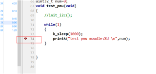

now i use segger development tool ,but can not breakpoint. but log aseggerlso cannot output information.

Hi.
What version of Segger Embedded Studio and NCS are you using, and what chip are you trying to debug?
There have been some issues with debugging in SES in the past, but they should be fixed in NCS v1.3 and SES v4.52.

version4.2.
Could you try the newest version of SES?
https://developer.nordicsemi.com/nRF_Connect_SDK/doc/1.3.0/nrf/gs_installing.html#installing-ses-nordic-edition
