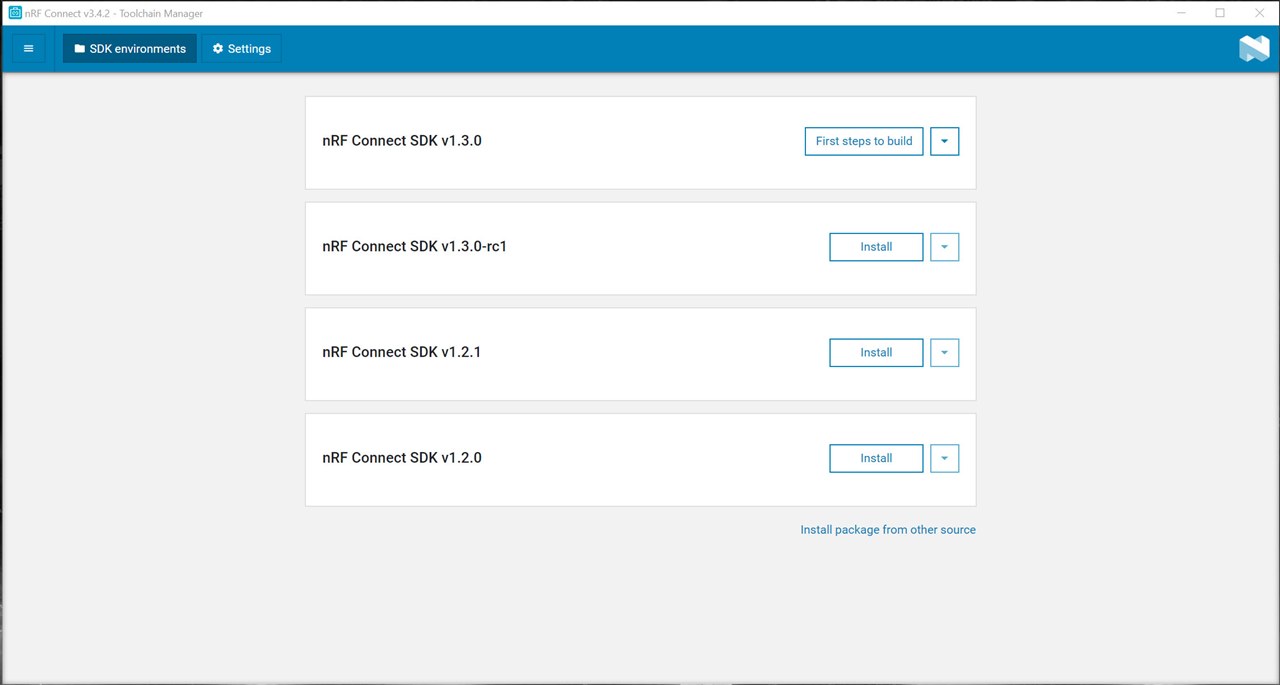

  • krog1 said:
    The "Open IDE" button doesn't actually show up for me on the Toolchain Manager
     Could you take a screenshot of what you see?
    This is how it looks like for me:
    Note that the number of versions might be different, depending on which versions you have installed.
    You can also try "Ctrl+r" to re-load the application. That might help.
  • Hi, thanks for the response Didrik.
    I tried the ctrl-R, but no change. I updated the toolchain and the SDK, but no change. Here's the screenshot:
  • That's interesting. I'll report this to our developers.
    Could you also check if the "down arrow button" works as it should?
    From there, you should also be able to open a command prompt (cmd or git bash), which should let you build from the command line.
    Also, what version of the Toolchain Manager are you using?

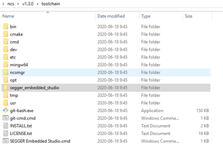

    Another thing you can check is if you have SES installed in the toolchain folder:
    Open the folder used by the Toolchain Manager, navigate into v1.3.0/toolchain, and you should see a folder called segger_embedded_studio, which should look similar to the folder where you installed SES manually.

    I have the segger_embedded_studio folder in the toolchain directory, and if I run the SEGGER Embedded Studio in the toolchain directory, everything builds properly even if I remove the cbor.py file I copied over.
    I just created a start menu shortcut to the segger executable in the toolchain directory, and it seems to work fine. I'll need to change this every time I upgrade the toolchain, but that's not a big deal.
